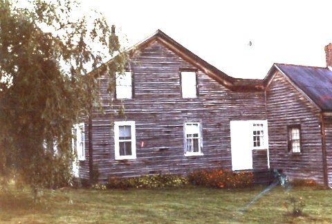

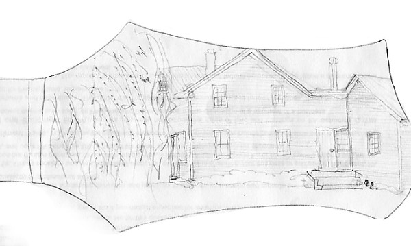

I'm making an "Adirondack guitar" depicting my Grandmother's homestead and some Adirondack things, to be given to my brother for his 50th birthday. He is very deserving of anything I can give him. I owe my life to him.
The pictures below should explain. I think materials should be wood for the clapboard siding, black pearl for windows, and I'll replace the willow tree with the spruce tree he planted as a child. (behind the willow, just out of view)
That spruce tree is already made-Holly stained green.
My question is:
1) does anyone have any wood veneers with fine grain lines to mimic the clapboards?
2) materials for a rusty roof, pansies, etc
3) Also, any other ideas are welcome. TIA!!!

etching may be the answer and remember you don’t have to etch every line full length. or inlaying individual strips. Getting the grain lines work well as you change perspective plane may be very difficult trying to use the grain to replicate the cabarets.
If you pay close attention to the cabaret lines in the photo you will notice that on the sides of the house the lines run at an angle toward a disappearing or vanishing point. (a perspective term) and the facing side of the house the lines run closer to parallel to the viewing plane. But in truth they too are merging toward a vanishing point as well. If you do not account for this perspective the view will come out with a flat, premitive apperance. I think etching will be easer to to pull the effect off.

Speaking of the perspective, the window on the addition to the right is drawn in incorrectly...

Just as you would with shell you can engrave lines into a hard wood. I don’t think you can braze them small enough to pull off the affect you are looking for. I used etch but engrave is a better term. A jewelers engraving set will do the job. Keep the engraving simple but affective. You want the lines to be clear and distinct at near edges and corner of perspective changes, but thinned out and disappear as they move closer to the vanishing points, but not all at the sane time. This gives a field of focus effect and keeps the image from being too busy. Google some images using “2 or 3 point perspective + sketch” to get some examples of what I am describing. If you use wood I would use something that has little or no figure and will oxidize to a grayish brown like popular. The problem here is that if you sand the wood the natural patina will be sanded off. So chose the media carefully. Maybe even consider something like black MOP or another shell with a brown gray hue. I really think engraving will work better than trying to use grain lines to form the perspective.

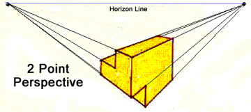

Here is an example of how to layout a 2 point perspective. You can increase or decrease the angle of approach to define the focal or viewing point. Now take a piece of tracing paper and lay over your photo and extend the edges of the eves and foundation from each side of the house till the lines that forms the eve and foundation meet at two points and you will have the vanishing points for that photo. Every vertical and horiz. line are based on these lines. This will make it easer to draw everything in good perspective with each other

Thanks Michael, for going out of way with the graphic. I hope many people who will one day search the archive get a lot from your help. I appreciate you!

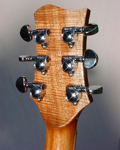

Terry, you're putting your inlay in my Omega headstock shape....or one almost identical to the one I've been using for nearly twenty years. I was surprized one day about seventeen years or so ago to have someone bring an early Olson to me for a little work. I'd never seen an Olson or even heard of Jim at the time and found it funny that we had chosen head shapes that were close to a mirror image of one another.

Terry, I'm just now getting to this thread. MP is spot on with the perspective thing. I actually took a class in art school called "Freehand perspective". If you trace the photo, you'll already have perspective because that's how the eye/camera sees things. If you draw it out, do as MP says. One thing to remember is that all vertical lines remain vertical. Otherwise the building will be leaning.

Thanks Paul. I'm on it too. I fully understand the challenge of finding any wood with a heavy vanishing point, esp for the very far left side of the house. I need to gather up some materials and start experimenting. Maybe I'll just use a full frontal of the house, using the spruce tree to break up the "one dimensional" feel. I just don't have a photo to work from

   Here's a photo of the rear of a headstock that i just sent to someone today who was asking about a Koa veneer on the back of their head.
   You'll notice that from behind it resembles the Olson head from the front. Purely coincidence. Stranger things happen every day.

Great project and your sketch is almost there!
SIDING
I really like Al Carruth's idea of using spruce (stained) for the sides.
WINDOW FRAMES
For the window frames you could use holy or whitish corian (shell is too brittle for such fine pieces).
WINDOWS
Check out the recent articles in GuitarMaker -- there was a 2 or 3 part series -- (author's name escapes me -- was it Nichols?) He used thin MOP for glass over a picture....cool effect.
ROOF
As for the roof -- check out Rescue Pearl they sell a lot of different colours/patterns of Recon stone that might work for the roof.
FOLIAGE
Green Recon stone. Burl works nicely for tree trunks.
GRAVING
A departure from Michael Payne's idea about graving -- I'd use a carbide tip pen (jeweler suppliers sell them) to scribe along a straight edge. The pen I speak of looks like a mechanical pencil -- with a carbide tip. It'll be easier to get a fine accurate line that using a knife graver. If you don't want to go to the trouble of getting the pen, use an exacto blade. Level the spruce after its been inlayed, stain as Al suggests, then a wash coat of shellac, then scribe and go over the scribed lines with a .005" tip Staedler drafting pen. (If you don't shellac the ink will badly bleed into the spruce).
I'd go with a 3-D drawing as opposed to your idea of a full frontal -- it'll look a lot better and give greater depth to your work.

Something else that may be of some help is to edit the photo and do some playing around with it to get some kind of plan as to where you want your lines to go. I`m using MGI Photsuite 8.1, and there`s alot you can do with it. Good luck.

[QUOTE=Terry Stowell] I just don't have a photo to work from
...[/QUOTE]
The one you posted on you first post will work
